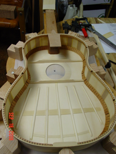

Hesh,
I've started using the bias tape also. Same brand, ironed flat and glued in with fish glue; soaked in the same manner but the glue is a bit thicker and dries crystalline similar to HHG. I then cover with a coat of 2 lb cut shellac to seal and protect the glue.
Here is my latest Yellow Cedar & Spruce flamenco with the tape applied:
Peter

I install side tapes pretty much the same way, but I use HHG.
About four years ago I did a little experiment with tapes and glues. I cut equal width pieces of broken sides from mahogany, padauk, Indian rosewood, and persimmon. I used both HHG and Titebond to glue tapes on them, using bias selvedge tapes and nylon twill, and I also made ‘null’ samples with no tape. I shellacked the tapes as I usually do. I made up a long lever, with a pair of dowel supports about 1” apart on the bench underneath, and a dowel between the lever and the test piece halfway between the supports. I then slid a can full of marbles down the lever with each sample in place, and recorded the location of the weight when the piece broke. This allowed me to figure out the load it took to break them.
Basically, any tape about doubled the force it took to break the wood samples. The bare persimmon took almost twice as much force to break as any other bare sample, so the tape didn’t help as much there. The padauk samples were more brittle, and were helped more by the tapes.
The nylon tape did not stick well to the glues. Not being very stretchy it tended to come loose from the samples rather than breaking itself, and then the wood broke at somewhat less than 'average' applied force.
The bias tape stuck down better with HHG than with Titebond. In some cases the Titebonded tapes also broke loose from the wood without breaking. Generally speaking the HHG tapes broke along with the wood samples, and it took more force to break them.
My conclusion, then, is that HHG works better for gluing down tapes, and that bias tape, although a weaker material than nylon, adds more strength to the sides. This result probably applies well to the case of stopping cracks from propigating, but it may not say as much about added resistance to shock at the tape location.
I’ve seen a lot of old instruments with either paper or cloth reinforcements glued to the insides. Generally, over time, the glue deteriorates with exposure to the air, and the paper or cloth come loose. I feel that shellacking the reinforcements should help prevent this, by excluding air and moisture. The shellac also acts as an adhesive itself, of course. We’ll know whether it works in about 75-100 years, and I’ll let the folks on this ‘board know about it if I can. :)
